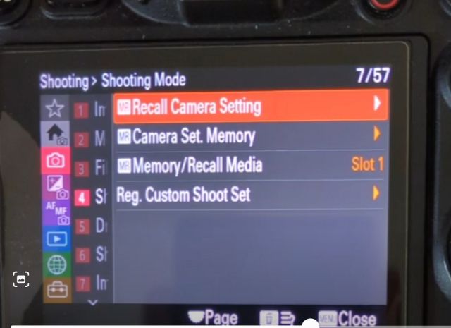

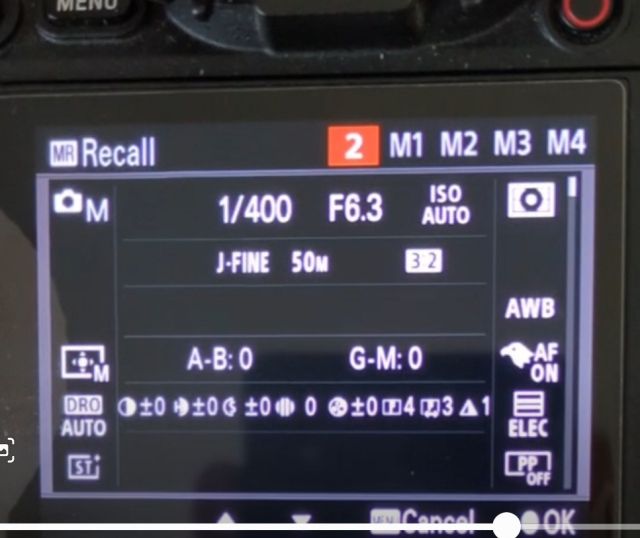

If l set the resolution to 21MB (APS-C cropped) and save it to Camera set.memory if changes to 50MB (FULL FRAME) on recall.
And if l set the camera to 21MB crop and switch the camera off and on it goes to 50MB full, a bit frustrating.
I don't think it did this with the old firmware.

Using v2.01, no change
GordonT
Do you have an A1 to try it on ?
