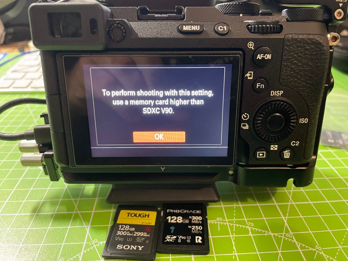

I have recently been getting the message 'To perform shooting with this setting, use a memory card higher than SDXC V90.' in video mode.
I get this with Sony Tough G-series cards and ProGrade V90 cards. Camera is set to record XAVC-intra frame, 1920x1080, 25P so not particularly high data rate.
The A7C II only has one card slot. My SDXC are the fastest cards currently available. The camera doesn't have a CFE type-A slot.
I can of course hit OK and carry on shooting as normal but this looks like a software bug?  maybe worth letting the engineering team know?

my A7CII is on the latest firmware and i’m still getting the warning message. i’m using high-end V90 cards (sony tough, Nextorage, ProGrade) but the message randomly pops up and i can’t proceed. i use the same cards in a Sony A7SIII and never have this problem even at the highest data rates in UHD 50p XAVC-intra.
I regularly have to do a factory reset, which wipes all my custom settings and swap the V90 card for another brand and that works for a while. My biggest issue, which no one is addressing is that the camera is asking for a card ‘higher’ than SDXC V90, and that currently does not exist in SD card format (as of March24). The camera doesn’t have a CFE type A slot so it isn’t an option. That line of code shouldn’t even be there!

I just had a Phone Call with the Sony Support and know probably WHY in my case it doesnt work.
Not for all cases, but at least mine.
Its not random ...
https://support.d-imaging.sony.co.jp/www/cscs/accessories/compatibility.php?area=eu&lang=de&mdl=ILCE...
I bought  2 different 32GB! Cards, both V90. One Sony Tough and one is Sandisk.
The error message is not related to the fact, that the Card is too slow. It has too little 'capacity'.
 Its ridiculous.
I believe they didnt allow XAVC-I-S 4K to be recorded on 32GB Cards. Even though the 32GB Card exists and has the more than enough datarate.
Therefore the errormessage is wrong.
Ive let the Support Person forward my inquiry to the Technical Team into why this unclear situation exists.
For what reason do you sell V90 32G Cards, if they do not work with your Hardware. You have to get at least a 64G Card to be able to Record XAVC I-S 4K. 80€ to 150€. (For the tough version). Could also get a 2TB SSD w. 4G/s Write/Read for that money lol.
