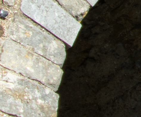

The CA is easy to spot I'm afraid! See the example crops below- the CA is the purple/green edging.
As an experiment I dropped the file into Lightroom and turned on the option to remove CA and it does a decent job:
