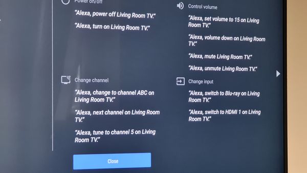

Clearing the cache has changed things as stated previously. When I ask the app to show available voice commands I get th3 list above.
All of them working with the exception of "change channel to channel 5" (example) work. So going backwards and forwards channels work - it's going to a specific channel that's the issue.
Have you possibly done some custom channel sorting by any chance?
No - not done any channel customisations (but I like yur line of thinking)
It's weird that it worked for GlasgowSteve but not for you. Are you on the latest software?
