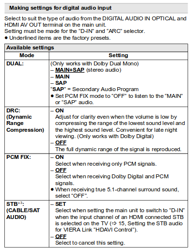

set your TV to Auto1 under sound-digital out and then try to change things on your HT
