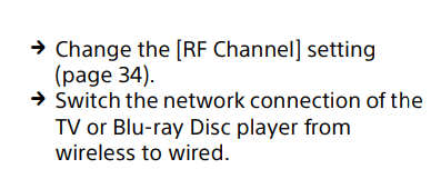

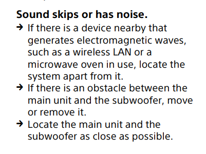

Hello @TheParader,
I found the following troubleshooting steps you could try:
The reference is to page 34 in the manual.
I would put my hopes on changing the RF Channel and only try the other tips if that doesn't improve the connection.
- Nic
Hi,
Make sure there are no electro-magnitic devices located between soundbar and subwoofer, if issue still the same you can contact Sony reps, they will direct you to the service center for inspection.
