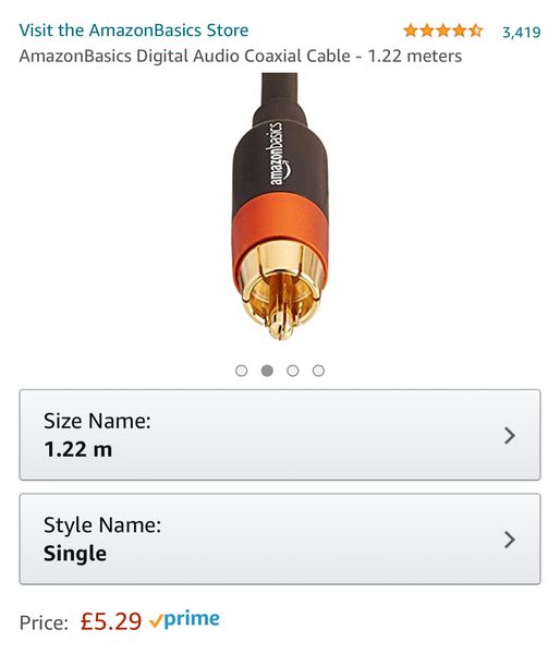

Hi Mazza23 and welcome.
I think the Digital Out on the SVR HDT500 is a co-axial connection and not an optical connection. It is an electrical signal conducted by a wire.
Check your Manual here:-
https://www.sony.com/electronics/support/res/manuals/4265/42650961M.pdf
I think you can get a converter box - try Amazon for ‘Digital Coaxial to optical SPDIF Toslink’
