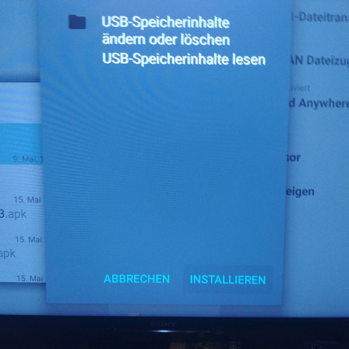

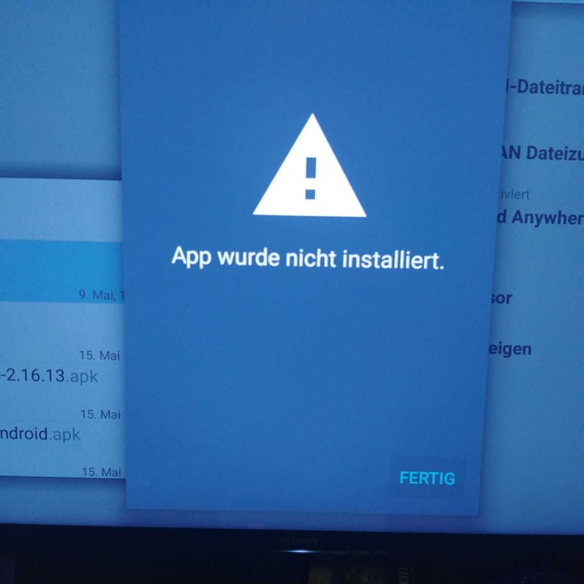

@jasones sadly I cant install it. I get no error, my Install button was greyed out aswell, the multitasking "trick" worked for that, but after my TV only says "App was not installed!".
-------------- EDIT !!!! ( PLEASE READ)-------------
Found a fix: The multitasking workaround ended always in the error "App not installed" for me. I was able to get the install button showing by opening and closing the action menu aswell, resulting in me being able to install this version.
Everything works! 3D,4K,HDR,...and the best everything still works inside of the Plex addon making this a solution for people who use Plex aswell. Even direct playback works for h265 inside of the Plex addon, not even the native app does that (You have to select maximume remote quality and direct playback in plex settings aswell as enable h265 for 4k direct playback and for 3d movies aswell, transcoded 3d does not work).
I am so happy now :), only thing I am worried about is: Who maintains this version? Can you explain what you exactly did? so others can recreate it once a update is needed to mask this as a Sony app, instead of having to rely on someone to update it?
