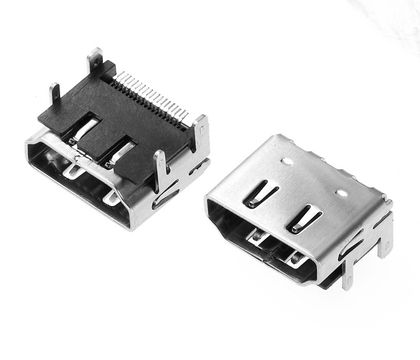

Seems to be an ongoing non solved issue, possibly related to defective receivers for many people. My suspicion is a bad soldered HDMI jack, on their circuit boards.
https://community.bt.com/t5/YouView-Boxes/TV-not-seeing-uhd-youview-HDMI-signal/td-p/1569408
or this
Also some people solved with HDMI splitter removal or adding.
I think that our Sonys do not support splitters.....
