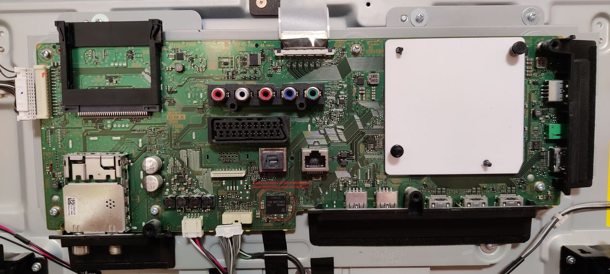

I said that I will not giveup! And I started to search how to repair the motherboard! Unfortunatelly is very complicated and to fix it you need to replace the FLASH MEMORY! See the picture bellow where the chip is marked with red:Red mark is the FLASH MEMORYRed mark is the FLASH MEMORY
Then the second issue is to write the firmware in the FLASH MEMORY. That's a challange! Because Sony is using a special PKG format and by myself I wasn't able to unpack. "Thank you" SONY!
Then I end to find out a service in Poland which they told me that are able to replace the flash memory with a new one with pre-installed firmware. Here it is http://naprawypłyt.pl/

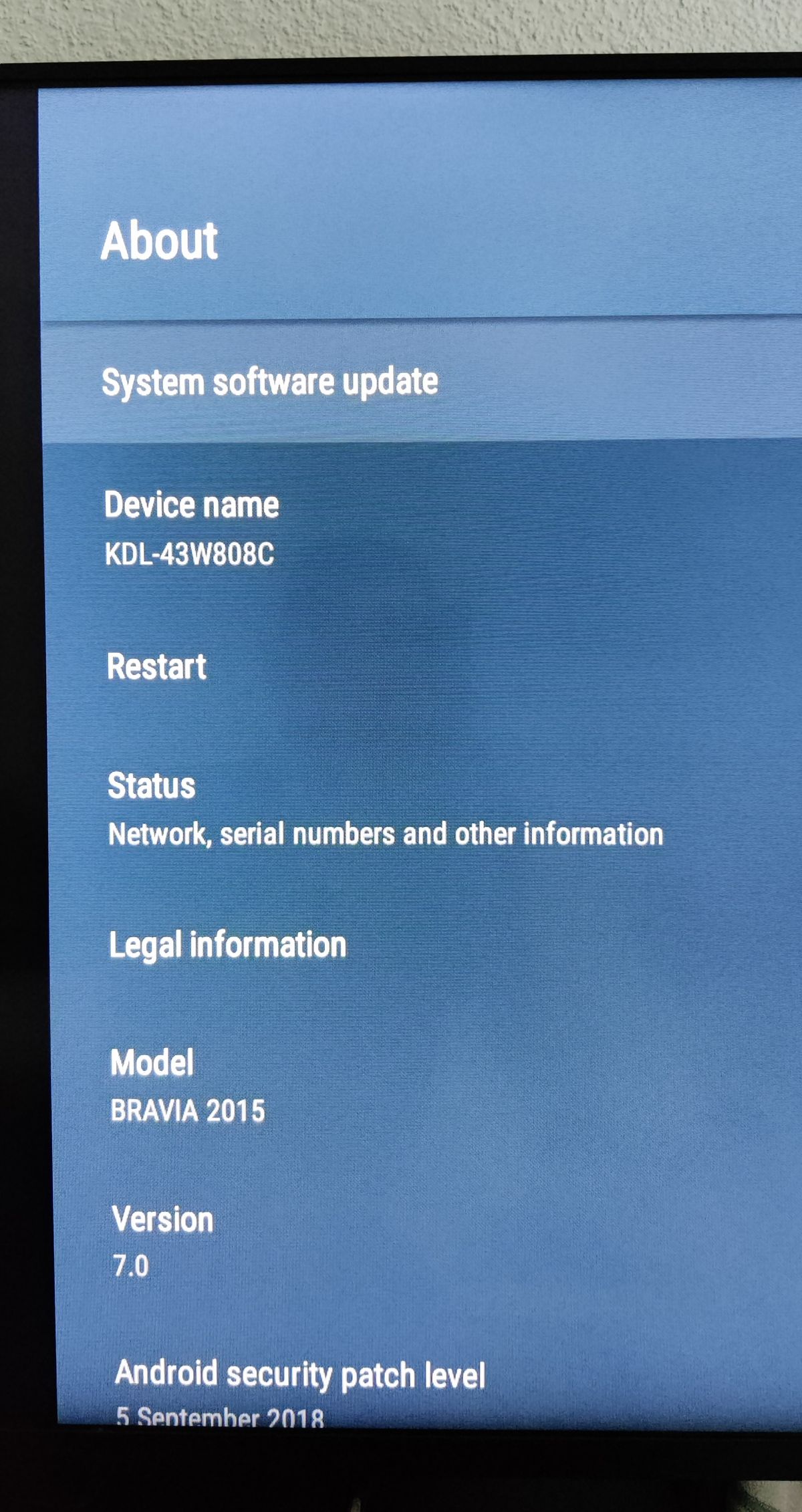

That layout interface shouldn't be the one for the KDL-43W808C.
So, that flash memory you got in. If you go to the TV system information page does it show the correct TV model and software version? Or, what's the number for the software version currently installed on the TV?

Hi @Anonymous ,
Before my old motherboard died, I had the same layout for IU. This is Android 7.0 Sony v5.417.
Indeed, when I installed the motherboard it had Android 5.1.1 and the layout was a little bit different then the actual layout.
I'm very angry on those companies that I supposed to throw away my TV because the eMMC chip failed and they are not giving us posibility to reflash a new chip to replace it!
Here is the software version:
And here is the chip which makes your TV to be good to throw away:
Price for tv: 700 euro. Price for eMMC chip: 10-15 euro. Sony is militating for sustainability and environmental protection: ZERO. Consumerism and polution: very to extreamly high.
What you have to do with your TV after this chip fails? Throw away, of course, and then you should buy a brand new TV.
But fortunetly there are some people that can replace the chip with a new one with a preinstalled firmware, as I mentioned in my first post.
Yesterday they annouced me that they replaced the chip and will send me the motherboard back.
