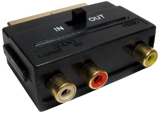

I have tried connecting the base station to both the headphone socket on the side of the TV and in the rear Scart socket with an adapter like this:
I cannot get an audio signal from either configuration.

No, and I may have been misleading with that image as the plug I have is not switchable. I just assumed that if I plugged it in then any output would be available to the transmitter, I guess I would have to buy a switchable adapter to be certain but you can imagine my reluctance to proceed any further with little guarantee of success.
UPDATE In the interests of exhausting all avenues I have ordered a switchable unit to try tomorrow. We'll see 🤔
Manolo
Well here we are again and I am sorry to say nothing has changed.
Switchable adapter arrived, installed and set to OUT. The wireless base station connected to it gets no signal. In-ear Sennheisers direct to a 3.5mm socket in a cable to the adapter also has no signal.

Last chance, and sorry if you have try (surely), have you set the adapter also to IN?
In this kind of adapter is difficult to have the right direction with IN or OUT.

Yes, I had to really just in case.
I have come to the conclusion (right or wrong) that with sound bar attached all bets are off on what you might expect from the TV.
