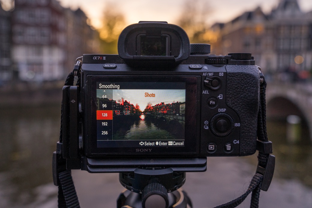

Start the App and choose custom. Sony put some presets in their to make it easier for the general audience, but I always choose custom as I’d like to use my own settings. The most important setting in this little app is the amount of ‘Smoothing’. Smoothing determines how much shots the camera will take & stack together. The minimum amount is 2 shots and the maximum amount is 256 shots. With an interval of 1 second that is a little over 4 minutes exposure.
In this example I am using a smoothing of 128 shots. The red pixels on the screen are displaying my focus as I have ‘focus peaking’ turned on.

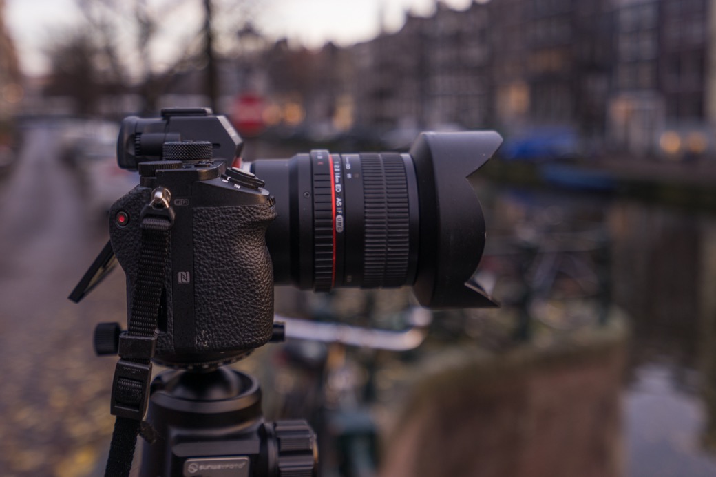

I am using the manual Samyang 14mm f/2.8 lens without a filter.
