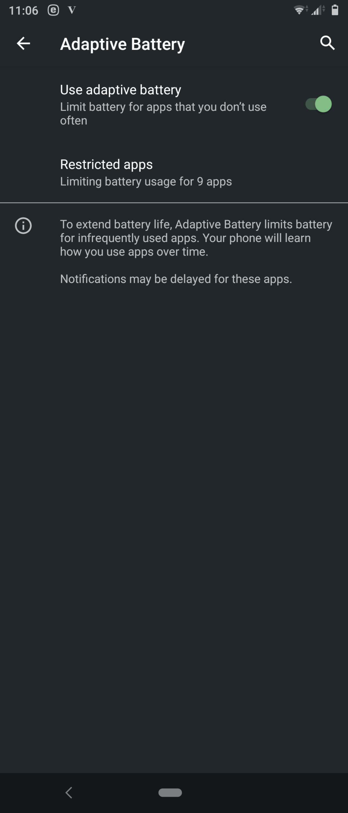

As for your battery life there are several options
1) a reset, starting with a clean machine (don't restore everything, just install most needed apps for a start)
2) restart your device once a week.
3) have a look at battery in settings, battery usage and restricted apps.
4) have a look at the support app where you will find tips.
