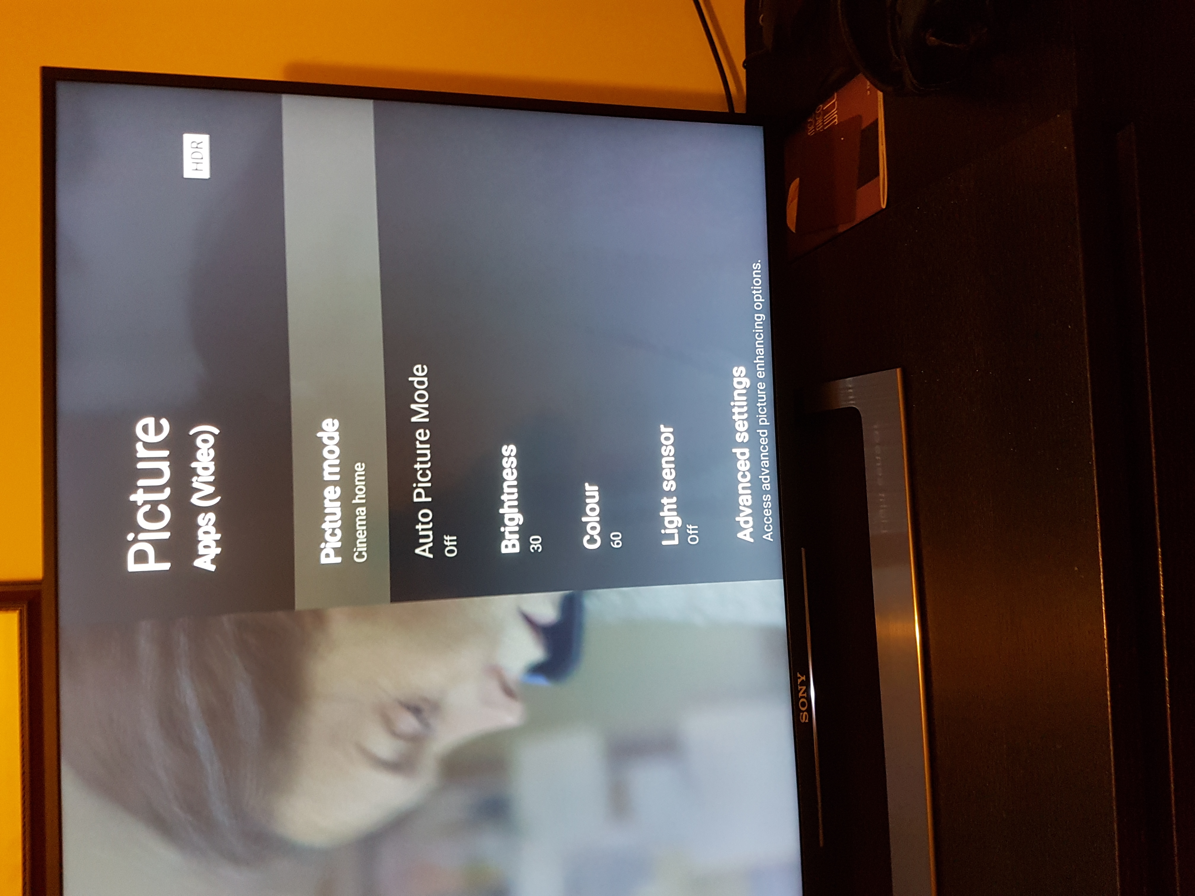

I have just tested OA on my TV (KD-55XD8577) and HDR plays just fine. If you press the [Action Menu] button on your remote control and then go in "Picture". It should state "HDR Video" under "Picture Mode". Can you confirm? See photo below:
Hi, i don't have the same option as there is no HDR video option on my TV. I've attached a screen shot. When I then go into video options there are three options:
HDR mode: this is set to auto
HDMI video range: for some reason this is greyed out but is set to auto
Colour Space: set to auto
Weirdly, if I then turn off HDR mode from the video options menu the screen gets brighter, but is not HDR.
So I'm flummoxed!
