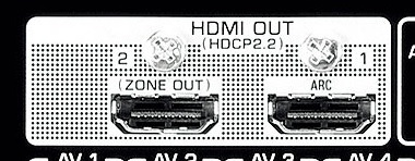

What I dont get is why you are using an optical cable connected to a *lovely* AV receiver. Simply use a HDMI cable instead and connected to both the ARC ports on the TV and AV Receiver - Your AV Receiver certainly supports it:

I did try and get the audio working via ARC but to no avail.
I'll have to check which unput I'm using on the amp ahd give it another go.
Cheers for the replies, I managed to get HDMI ARC working and this has resolved the issue.
