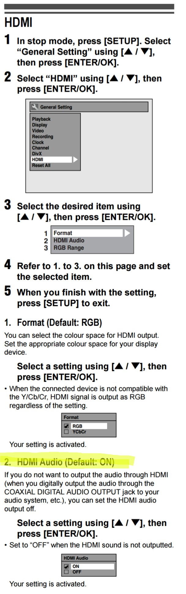

This is the setting I was meaning: HDMI Audio - ensure that it is ON.
I also found this, whether its relevent to how you use it though?
Calistinson
Tried these already, tried again just in case, but still no joy.
