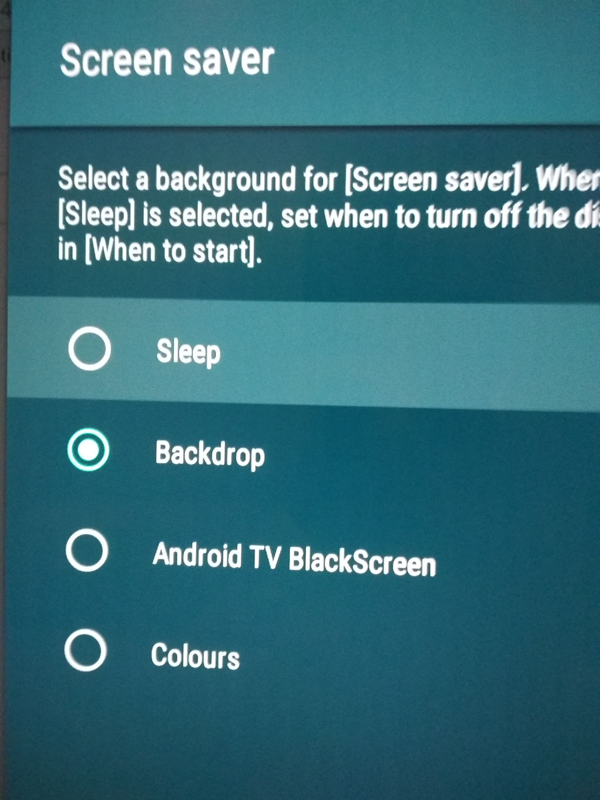

Yes, I disconnected everythig: PC, Receiver, Wi-Fi, moved mobile phone to another room, pooled out battery from the remote. Nothing helps.1.jpg1.jpg22.jpg22.jpg

And what does it do when you choose the options other than “Backdrop”?
sunnyryz
