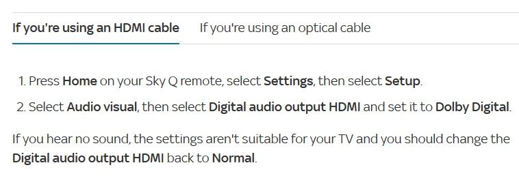

This is not how I would have it 'wired' up.  There is no need to split the audio from the SkyQ Box to the BDV-E370.  It also gives you another point of failure and added complexity to your setup.  So remove that Optical cable,
It should look like this:
SkyQ (HDMI Out) > TV (HDMI IN)
TV (HDMI ARC) > BDV-E370 (HDMI ARC)
Sky Box Settings:
You will need to change some settings on the Sky Q box as its most likely the audio settings are set to output via optical.  You need to set this back to HDMI.  This is what you need to do:
